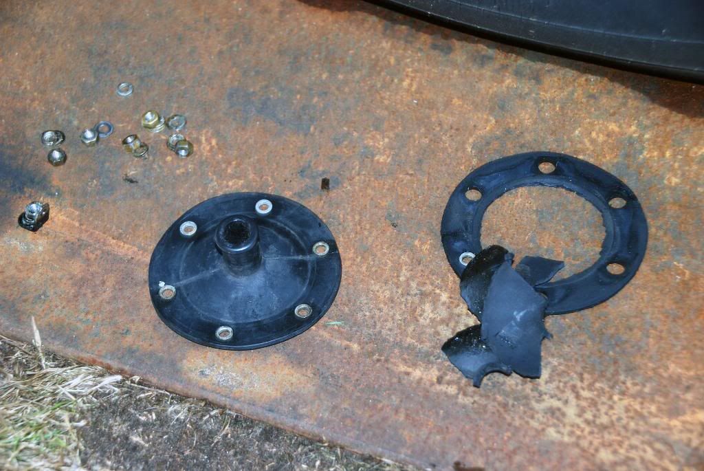

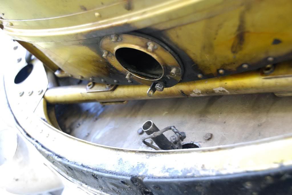

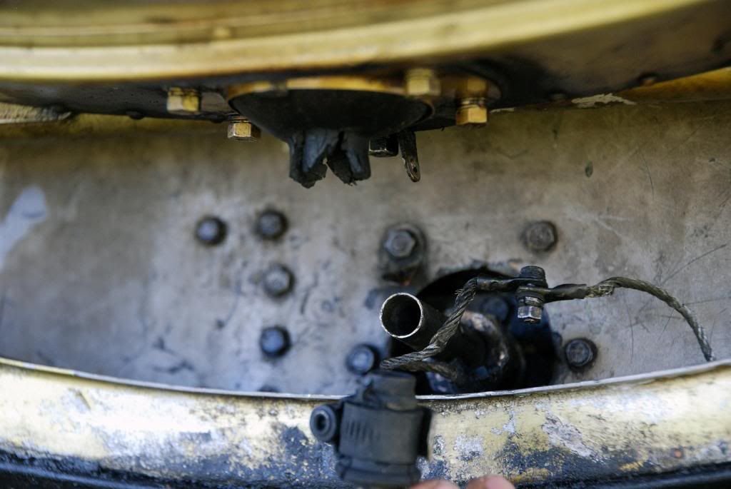

Postby Richw_82 » Sat Jan 07, 2012 11:42 pm
7 Jan
First work day of the new year, and it wasn't too bad yet not great either. It was one of those days where even the tiniest of jobs seem to take forever, and lucky me - I got that job!
On the last couple of runs we had a fuel leak from the drain under No 3 engine (its always 3...) it wasn't the slow running cut -off issue, just that the drain on the bottom of the intake had a rubber collector cone on it that had perished.
Getting it off looked simple. It really wasn't.
The six bolts weren't captive. The ends had been punched over in three places to lock them off. There was about an inch gap to get your hand into if you stuck your arm in the intake throat.
Perseverance won.
We got the new one on but lost quite a bit of time persuading it all to go back together. Fuel should now be dumped down the drain pipe, and not onto the tyre.... something that would not be desirable when we get the new wheels on.
