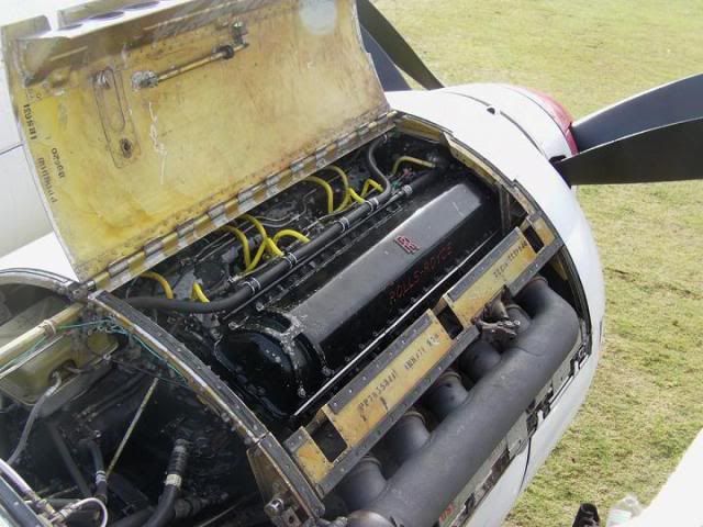

Progress today saw the last parts of the new inlet ignition harness in and fitted on No 3 engine. It was a pain and required a lot of thought to get plugs and leads all in the right place, but patience (and plenty of cups of tea) won out in the end.
At 1541hrs, No 3 engine was turned over and with a little persuasion brought to life. A little later than we normally run, but the boys from the fire station were fed chocolate cake to keep them happy until we were ready to go.
To all gathered, the engine sounded pretty sweet so once there was some temperature in it we opened her up and let her roar. No misfire, popping or other shenanigans were evident. Time for the magneto test. Left, right, then lower the revs to 800 and test both to make sure "Off" is indeed "Off".... A fully serviceable engine is allowed 100rpm drop per magneto. 963 got 50rpm drop on each side!
The only niggle is it appears she likes running too much, the slow running cut off system didn't perate properly meaining the engine tried running on. Given the bad weather has just started, its possible that the solenoid in there is unhappy, but we'll check the whole system out just to be sure.

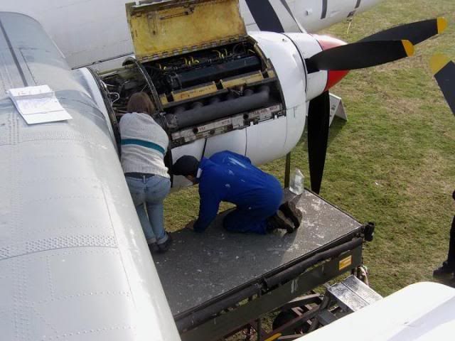

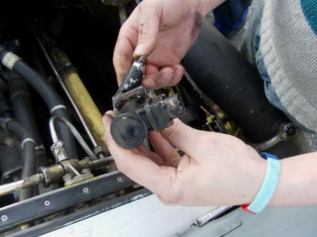

Moving on to all things Shackleton - we dug into the problem No 3 engine had (it's always No3... that engine hates me. ) regarding the slow running cut off, and its failure to operate.
With power on, we tested the fuse, then the circuit, and finally the solenoid; and found that it was intact, and appeared operational. We pulled the solenoid and the cut off valve off, stripped it down and cleaned it. While the solenoid comes apart fairly easily, the valve appeared to have a sealed body, which made life difficult.
After cleaning and lubricating we reassembled the parts and refitted them to the engine. Trying the system again and once again fuel poured down the intake drain and all over the floor and starboard tyre. The offending solenoid/valve is still unserviceable and will be replaced by a new one next week.

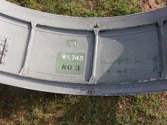

In order to make it to the end of Shackleton service there was a lot of parts robbing of dead aircraft, and '963 received bits that can be traced all over. Once or twice taking cowlings off we've found stencils of other aircraft serials, as found here:
One of the other engine cowls is off XF700 (which is on the dump at Nicosia), and there's a couple of others that I've forgotten.

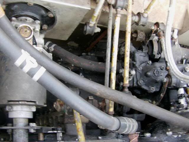

The slow running cutoff is buried deep at the back of the engine so it took some digging to get to. Myself, Gary Thorn, and Ron Thompson got the cowlings off and set about removing it. With little to no wind, you can have the Griffon AP on the wing at the side of you which makes life a little easier!
There's a driveshaft going to the accessory gearbox runs past the valve meaning as with most parts, you can see it, you can feel it, but you can barely get a socket on it! Centre left of this picture is where it hides, just under the two pipes -
And this is the bit when we finally got it out.
