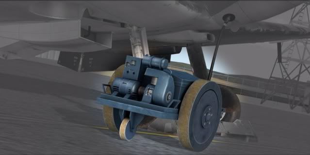

pic of a spitfire one comming up cant post at mo got net nanny at work :(
done :)

Dougs, Thanks for the input, :ymapplause: I think the engine powered version is an early type form beginning of WWII Battle of Britain era, pre-P-51D era. The other one is a Trolley Acc(batteries in a box) but I am not sure if that was in service at the P-51D era either.

I think you are right. These accumulator trolleys were probably locally manufactured by the squadrons on their home station, where they wouold be re-charged by the unit battery servicing room. However, if operating in a Belgian field on deployment, the trolley would likely have had the generator set attached, to top up the trolley accumulator's batteries after a number of aircraft start ups had depleted the charge. SOP was to start engines from a trolley accumulator, so the aircraft battery would rarely drop below usable as it would be constantly charged during flight by the aircraft engine driven generator. I reckon I will probably go for the normal trolley without generator as I believe the P-51 outfit represented by the kit probably operated from a permanent UK base until after D-Day. Still haven't found a photo of a Mustang attached to a trolley yet.
