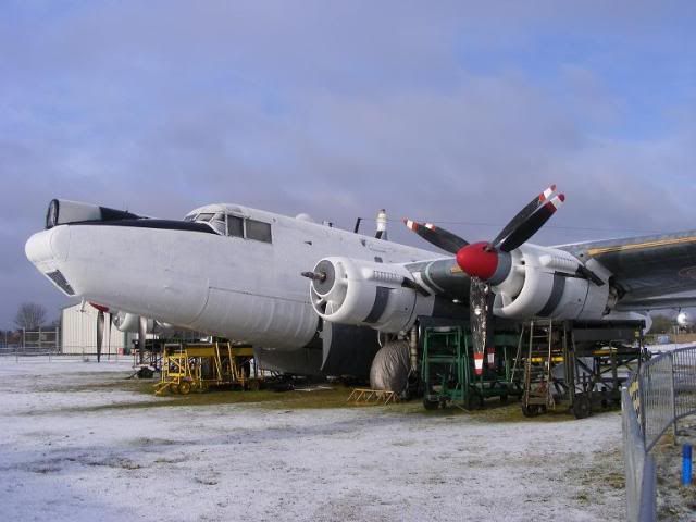

A brief look at how far this old cold war beastie has come in the last 12 months. This was April last year - we hadn't ran the engines since 27 Jan 2010, due to an oiling problem causing horrendous camshaft wear (some of which is still left to rectify)

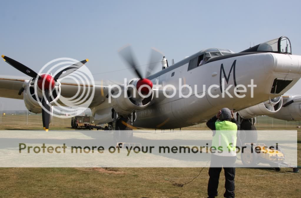

5 Feb 2011 saw two engines fit to go. Attempts at getting the Coastal scheme done had been stalled by the weather, but at least we were running now after 13 months of silence.
The long term aim is to get her back to the condition she enjoyed in 2008, when she got out on the runway for a fast taxi. If we can achieve that by the end of the year, we'll be very happy, given that this is WR963's 20th year in retirement.

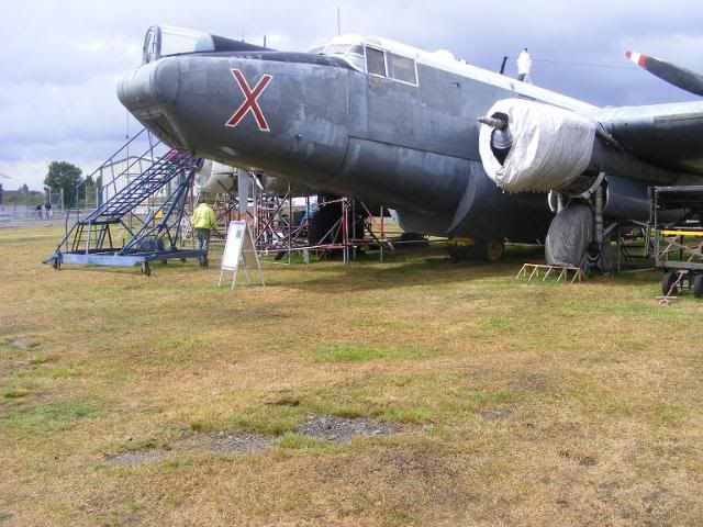

The aircraft's exterior was in a bit of a state when I first got to Coventry It had been repainted around 10 years ago into 38 Sqn colours, and by now it was ready for doing again. Other bits that had not been touched were now begging for attention too, the sealing tapes used to cover joints were all rotten and peeling. The aircraft was leaking like a sieve, which had a knock on effect on a number of other systems, the worst being when it got into the fuel system.
This is what we started with:
This is the wing cleaned and with new sealing tapes applied:
Which then looks really great when you get a coat of BS381C 637 medium sea grey on it.

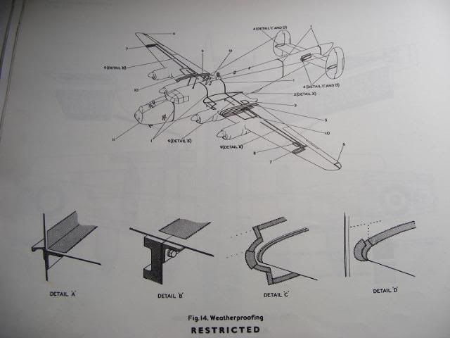

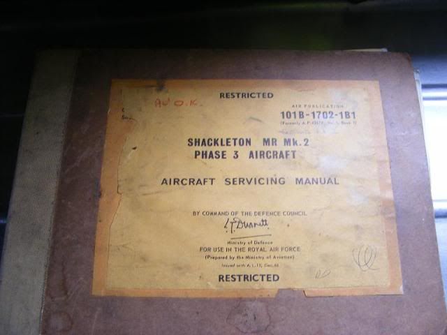

Thankfully we have all the manuals, like these:

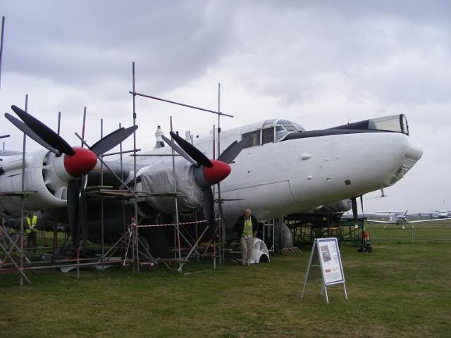

We've also got ALL the design drawings for the Shackleton, which amounts to some 16 tons of paperwork. After getting the sealing done, we had some scaffolding erected to work from This brought about some really amusing internet rumours like the undercarraige being removed, or that we were breaking 963 up.

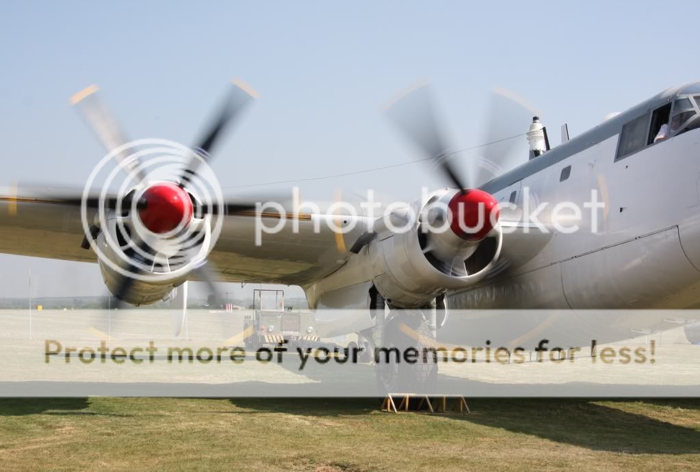

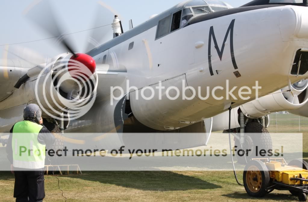

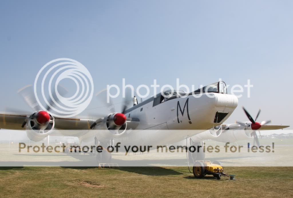

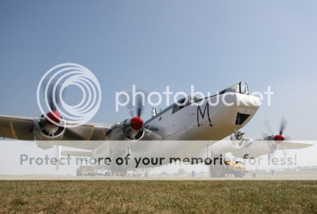

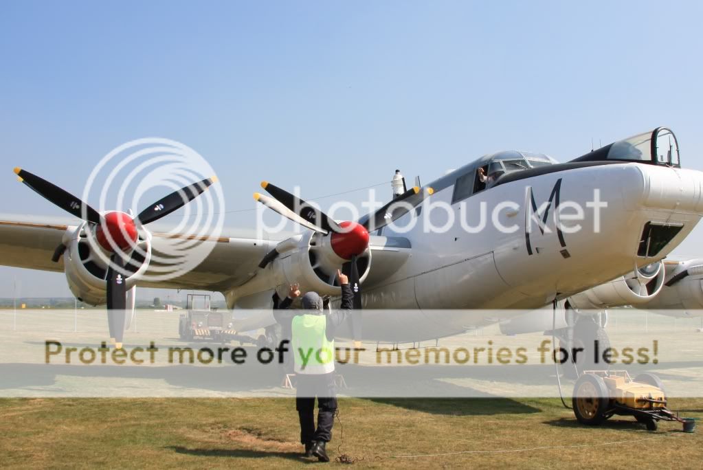

So at 13:00 and with VIPs aboard, START No3 was signaled.
Power was brought up……..
And the bomb doors were exercised revealing that capacious bomb bay.
Just look at the power as 3 and 4 come up to speed.
No1 comes alive.
She lives…….
THANK YOU for a CRACKING SPECTACLE! :ymapplause:
